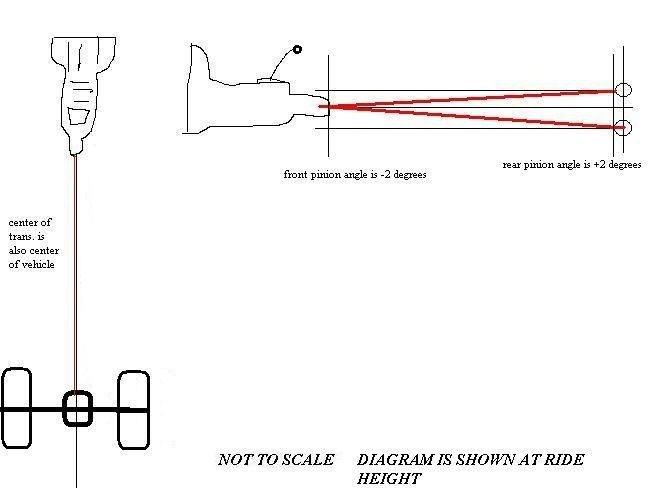

that help any mike?
when the drive shaft is strait and the rear axle isnt fixed(irs)that is maximum length and would push the drive shaft into the tranny or cause premature u joint failure.
theroeticaly(sp) if you moved the rear end to center w/ the trans, as long as the working angle of the drive shaft/rear end is higher/lower then the center of the trans the u joints would be fine till the 2 planes crossed on the same parallel, it would push the drive shaft furthest 4 ward and cause bad vibrations/break stuff at the worst.

the working angle of the drive shaft is also at ride height.
