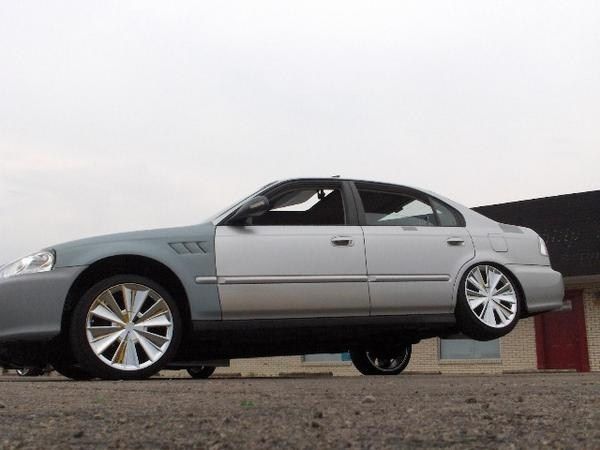

your question has been answered several times in this post. i had it on my 2000 civic and my 91 civic and 93 civic. its not rocket science. wire the up valve on the top port to your down valve on the bottom port. then wire you down valve on the top to the up valve on the bottom port. tie your wire in together on your wire block. no need for another switch. but heres the thing with only having one side with 4 valves you will drop faster on that side so you will need slow downs to make it work even. and still the ride will be alittle different on that side. so you need to get 2 more valves if you want it to ride right. but with 10 switches this is all you need to do. i hope this helped ya here is my old civic

The i done it is you hook the top up like normal and same setup on the bottom just your down valve is always open so on the extra switch get a on-off-on wire it to where the down valve always has power to stay open so the car goes up and down like normal but when you put the switch on off the valve closes and the air can't go in and out so when you hit the other switch the wheel will go up and you just dump your normal switch aand it will suck up in the fender like the car above
