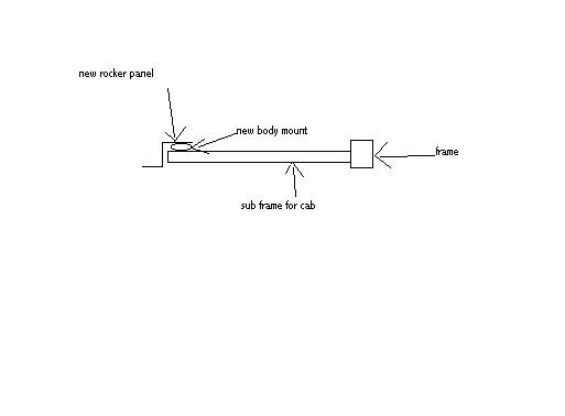

I was thinking about building a new frame work to support the cab out of like 1.5" x 1.5" tubing and putting the mounting points further out closer to the rockers. I thought I could bend up like a z channel out of 1/4" for the new rocker and then use the that for the body mounts. Hard to describe.
huskerdually
^^^I got mad paint skills!!^^^
