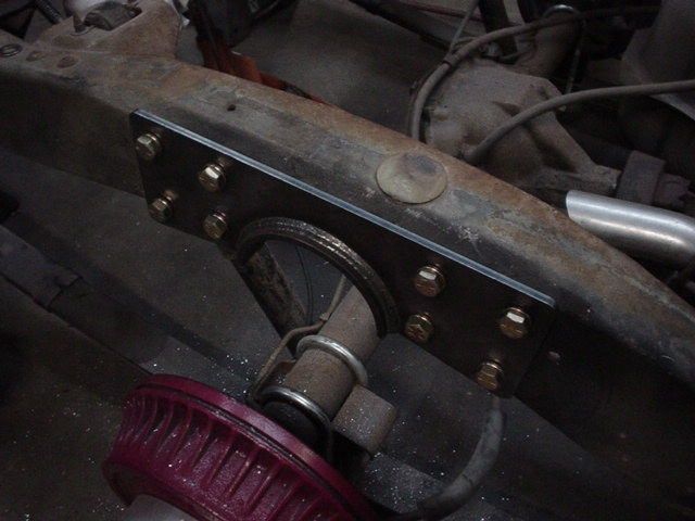

Yeah, I just did a little research. a 6" will cause the axle to hit the frame. so a small basic c-notch is going to be your best bet. and definently a good set of shocks. (this is just what i've heard from a few quick websites)

i have a 95 sonoma with a 5/6 belltech drop with 19s and I drove a little bit with just cut out bumpstops and hard bumps would make the frame smack the axle and sounded horrible. My fuel pump went out so while i had the bed off i put in bolt in c-notchs and now it rides great other than the tires scraping the front fenderwells. When you put in the notches you have to remove the charcoal canister and rework the brakeline bracket on the driverside. Also, there is a little lip hanging off the front of the upper bracket connected to the axle that holds on the leaf springs. I trimmed that a little as well so there was no interferance. Let me know if you have any questions.
