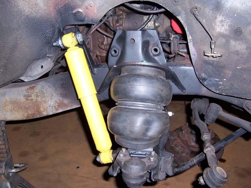

I have read thru many posts on a couple different sites and just want to see the bag mounts and how you guys have attatched them. Im getting ready to bag the front of my truck and need pics to look at for reference.
What kind of mounts should I use? Do I just need a flat straight mount for the bottom? Im only going to be running the stock wheels for the time being and Ill be using 2500 bags.
Any help would be great because at this point in time Im a bit overwelmed and I really want to lay my truck out.

2500 bags make it allot easier..Here is a tech article on doing it.http://www.lowdowncustom.com/tutoriaux-d6.htmlLaterzPhil
whynotfab's avatar
whynotfab
You can also get the basic idea on my site, the pics are from when I did my Yota.. but the torsion setup is basically the same. You'd see the obvious differences when looking at the two. Good luck

Would brackets like these work for the front of my truck? http://suicidedoors.com/RearUpperBagBracketSinglePort.php#
I know id have to brace them though.
detached's avatar
detached
http://suicidedoors.com/TorsionFrontAirbagBrackets.php these are what you need.
those are the best brackets besides silver star customs brackets i have seen only reason i used silver star was cause when i bagged my mazda in 2003 i got it all as a package f/b air ride kit with brackets were 700 dollars shippped they had a special going on back then..
