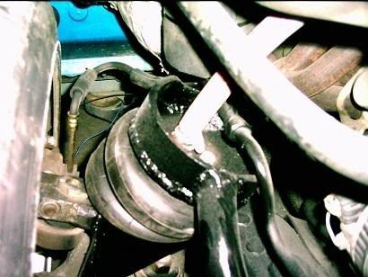

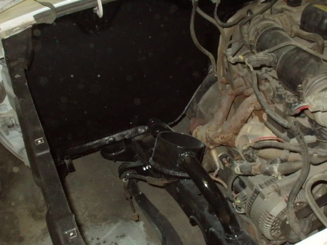

Best way to do it is too ditch the beams and go to yota front clip.Other then that, I've seen guys make the SD brackets work on smaller wheels.I did a 94 on 20s and made brackets from scratch. I mounted the shocks off of them as well.The tabs in the first pic is for the shocks. Just mounts to the stock mount on the radius arm. On a side note, I'm getting sick of these threads. theres like 1 a day. Just look through the ford forum.

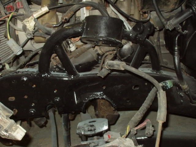

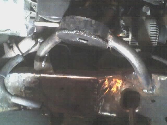

heres the way i do the ibeam brackets, pretty much simular to the one the other guy posted..
