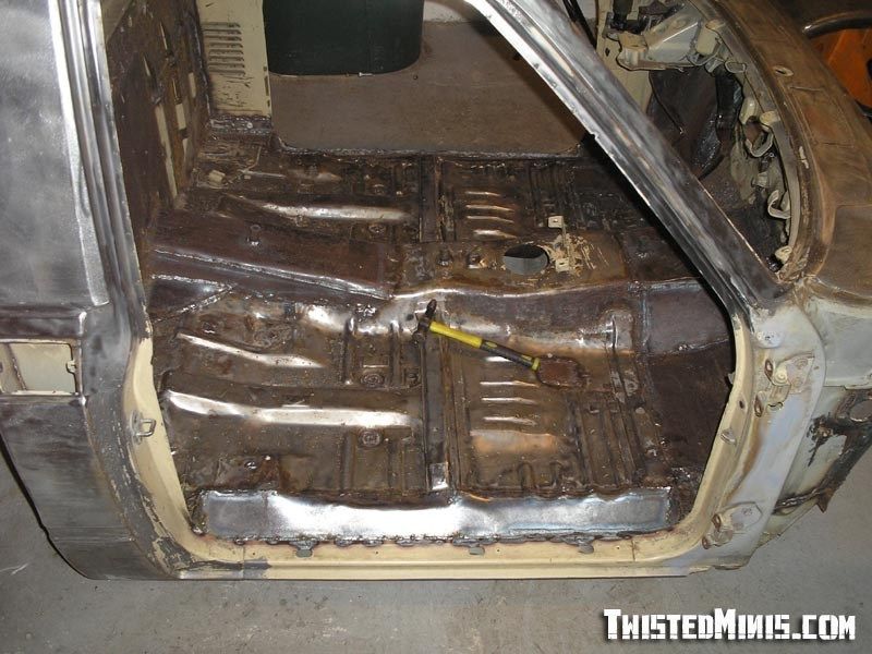

I used 16 guage. You can still beat it into shape if need be with a decent hammer. I rolled the edge of mine over my floor, it was damn easy to weld.I hate butt welding thin metal.
rrusd's avatar
rrusd
Damn Seth, that looks almost exactly like mine. I did the oversized pcs. and bent them over with a hammer also. Came out real nice, and like you, I hate butt welding thin metal. Makes for a lot of hole fill work from the POPS LOL.
