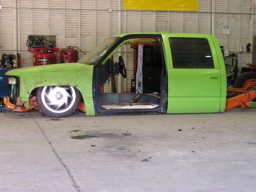

bdydrped's avatar
bdydrped
mines not z'ed either. only had the raise the trans tunnel 1.5-2" if i remember right
heres a link to all the pics
i really need to update that though i have some more pics withthe trans covered and the floor all rhinolined...

krewzlo's avatar
krewzlo
mine is not z'd but doesn't lay out in the front on 19's. The skid plate hits about 1" from the rails touch pavement. I won't z it so I either live with it or raise the skid plate, notch for tierods and any other things I will run into. It is kinda nice to drag the skid without hurting the rockers.
bdydrped's avatar
bdydrped
"stockfloored" thats why in the shot of the door open there isnt a 4" chunk of metal holding the body together....
mine is a diesel frame and doesnt have the raise in the frt as much as the gas frames do and the actual frt crossmember/skidplate/susp is up off the ground bout 3/4" and it will lay on a 45 series 19(if i remem right) it has 275/65/16s on it.... ill try to get some more recent pics of it.
