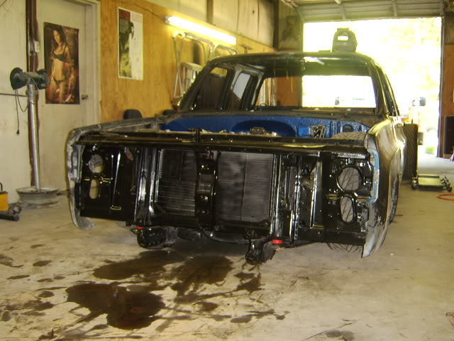

the main reason i dont want to change the rearend is because i would have to change my bag set up and i dont want to do that. I work at a body shop so it would be free do just extend my fenders? i just wanted to see how they looked (if it made truck look to dam wide) looks like i will need to widen about 2 1/2 inches

this is the only pic i got of the front right now! as you can tell i got a wrecker 4 runner in the way of taking a good side shot

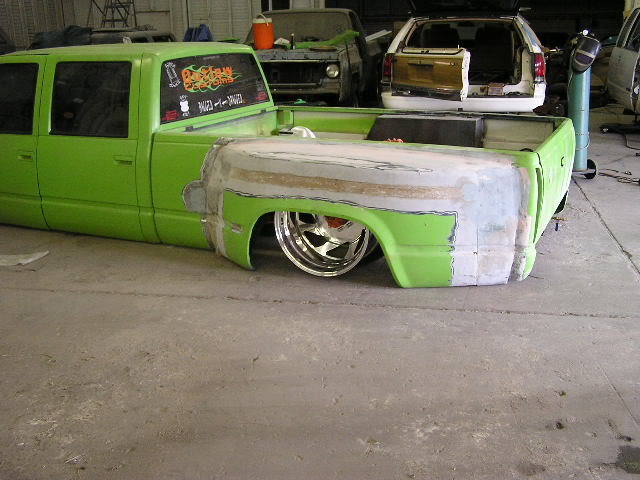

this dually had its fenders widen, i think he said they were maybe ~4 inches wider.bringing his dually width just under the legal limit of 8'8" for highway operation.

That would make it real fun to park, a extra 8" wider, LOL
