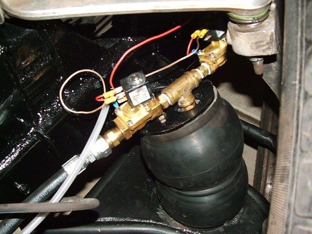

I put mine right on top of the bags. It is killer fast with 1/2 line and fills at 200. Too fast for me. It is really load also which I like. I just ran wire and gauge line to each bag. I am running hydrauil line so it's realy stiff, therefor no flex to cause leaks. I havent had a problem at all with this setup.I did mine like this, right off the bag

damn jerry that goat looks killer,and yea the closer the valve 2 the bag the faster,i have the same line as jerry and that is the only way 2 go u wont ever have 2 worry about anything
