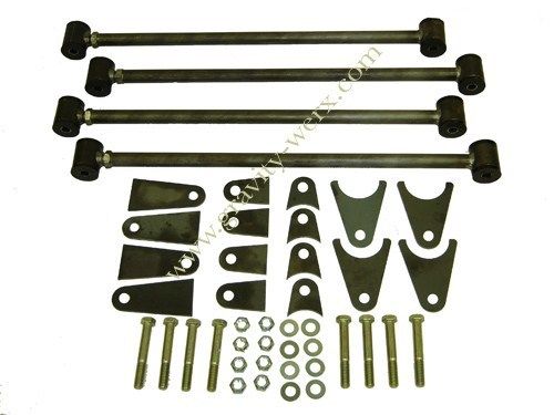

or you could buy the sweet wishbone setup i have in the classifieds, some bolts and some tabs and you have a sweet setup.
