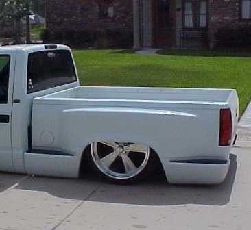

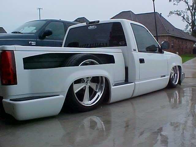

one of my friend's dad has a paint and bodyshop over here close to lake charles, and he did all the work for me. the bedsides were cut and raised 3 3/4" total to clear for the 22's
///DragBdy's avatar
///DragBdy
here's a lil before and after pic...
