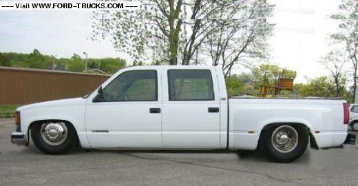

The fenders will fit they just look a little funny in my opinion. Her is what my old truck looked like Crew Cab short bed.

I'm almost 100% positive that GM made a factory crew cab shortbed dually. I remember I read a little blurb about them in Truckin' in the late 90's, but it could have just been a concept truck. However, I have seen one before. There is always a chance that it was a custom deal, but the truck was otherwise stock-looking.
Anyway, I second Lock, they will fit on a shortbed.
They do look a little silly though.

They probably would be a little silly with no space to the front or rear of the fenders, just going right into the back of the cab almost.... Hmmmm...

I guess it does look funny with the fenders, but that picture without fenders looks right....

Yeah, I think the fenders look way silly on the short bed....

Actually GM did build a short bed dually for 2 years, it was available in 99 and 00. from teh factory only availbe as a crewcab.
they looked unproportional as hell IMO, i would much rather do what lock did and build a 1/2ton shortbed crewcab.... looks hella clean.

My truck started as a reg cab short box truck and I built the frame to fit the crew cab.

Dad has a 99 crew cab shortbed dually. It does look a lil wierd...
