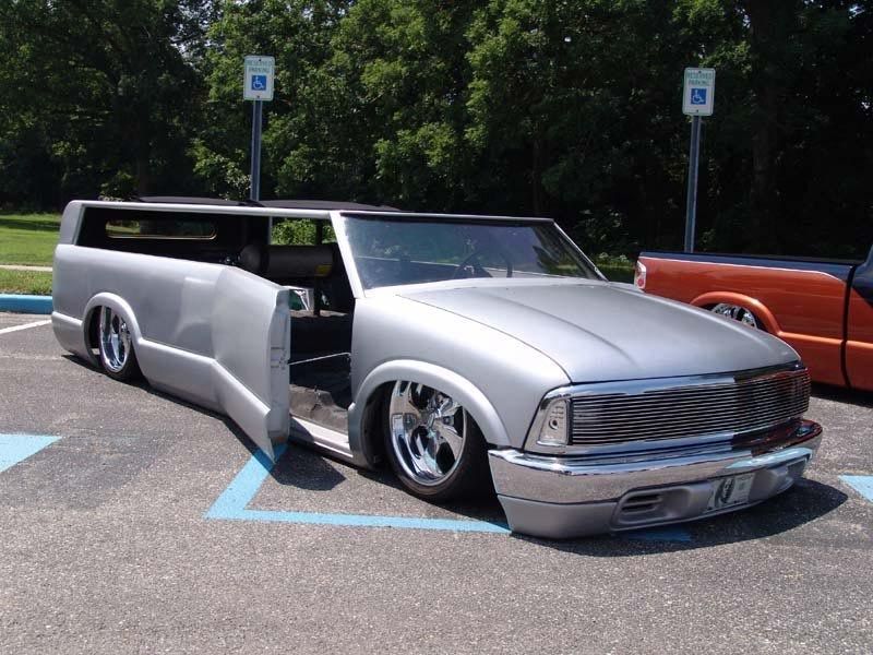

heres a friend of mines truck. he left the bed in the sock position then used pieces from another bed to bridge the gap between the bed and cab. its well braced inside. he also used the rails of the other bed to cap the doors off with. great truck and should finally be done by next spring. This thing was started almost waaay back and he just hadnt had time to get to it again until recently. im glad to see it coming together again
