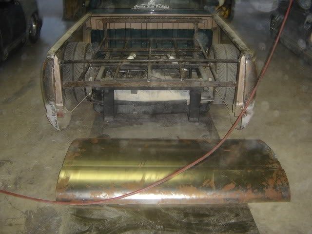

i did this on a customers truck....moved the stock tank to behind the axel and built a beefy ass square tube "cage" around it and it works fine, his is a 97 vortech 350, biggest hassel was gettin the filler neck tubeing bent so that the gas would flow and not stayt in the neck.
sorry for the crappy pic but its the only one i had up loaded

that backhalf doesnt count im assuming hes talking about a stockframe.
