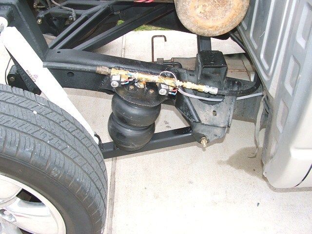

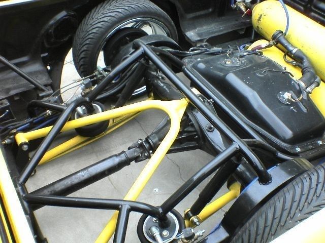

Here are a couple that I've set up, both ride great. If you're gonna run an over the axle setup, the only way for it NOT to ride like a dump truck when aired up is to run a sleeve typ bag. They've gota more progressive spring rate and ligher load capaicity than a double convelouted bag, and will offer a much nicer ride in a 1:1 setup.

shocks can play a role too, the two set ups ^^ , not to hate, but the shocks are pretty much doing nothing for those rides.

no..they dont do shit when they're laid out
The type of shock also plays a HUGE roll, not just the position. The black mazda is running factory replacement type shocks, and when it airs up, the shock is in dead mid stroke and dampens quite nicely. The grey one, I used a set of ProComp ES9000's. It's a twin tube 10 stage shock and is about the stiffest damn thing I've ever used...took 2 of us to install them. That's the only reason they do anything at such a sever angle, while only using a small amount of their available stroke. I am actually going to raise the shock mount up a bit in the back to get them to be a bit more effective.
Dont forget too, that factory shocks arent straight up and down either....
