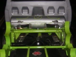

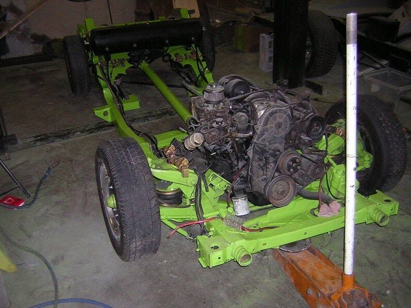

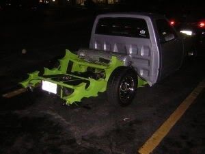

here is one kinda
dubDyme
i did my own rear clip, this is how i did mine (not saying its right or wrong). i made both of my rails, layed them next to the stocks marked on the top of the stock rails where the tubing would need to go into it, then marked at the bottom where it would meet up. cleaned everything with grinder. cut the top of the channels where i could drop the tubing into the stock frame, tacked in place, measured a billion different things a billion different times, welded it in solid and plated it in. plug welds are always a good idea and add tons strength if done properly. i think i ended up with like 500 or 600 in mine, thats with new fuel tank, four link parts, and materials.
