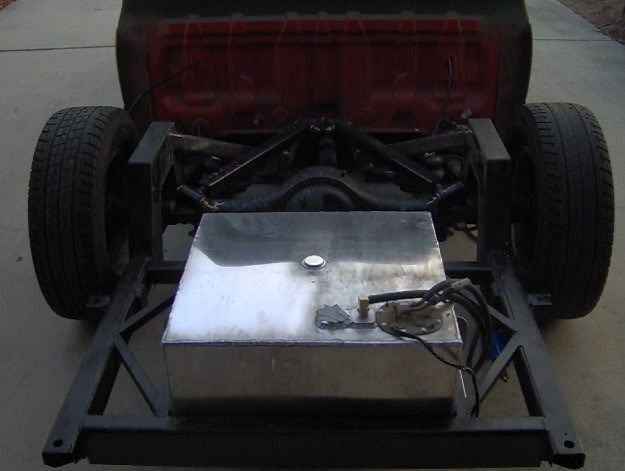

here's a pic of mine its a bad pic. I got more pics also in my profile
