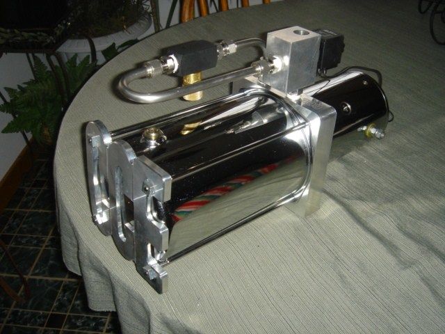

heres all my stuff. Every fitting is stainless steel, all the hardline is stainless tubing, everything else is stainless braided 3/8". Fittings are by swagelok, as is the hardline, and braided line. Swagelok is considered the standard in fittings and hoses when it comes to manufacturing companies. the are gaurenteed for life, and can be tightened and loosened as manytimes as you need and no parts need replaced. they are also stable to 25,000 psi.
swagelok.com
