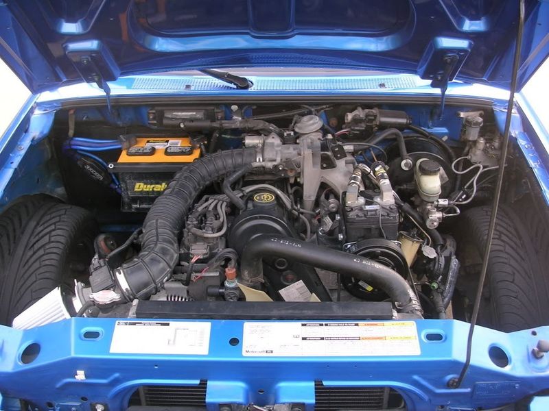

Mike, did you extend the big bundle that runs over the driver side front wheel?
msturg's avatar
msturg
yeah, heres a pic of what it looks like now.
