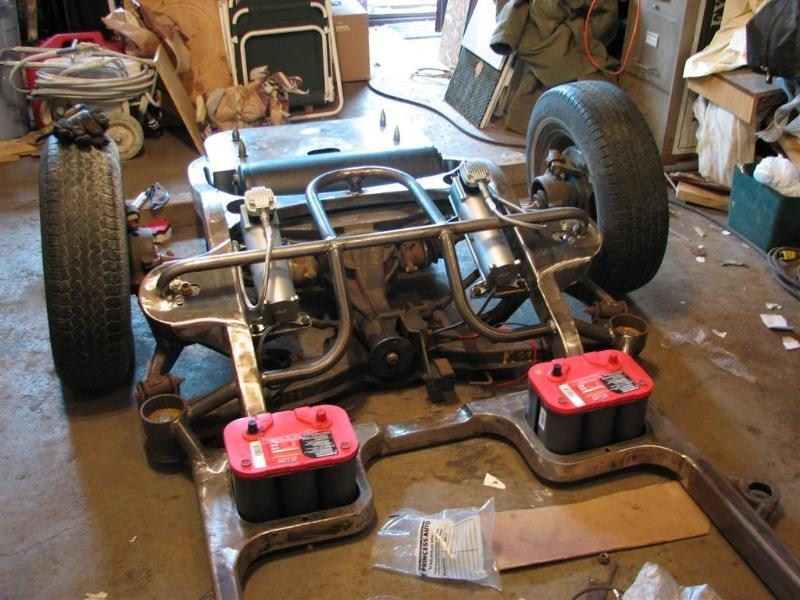

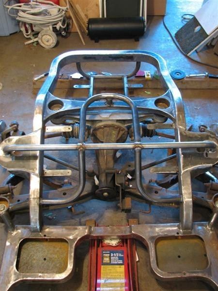

hey man ... i got a 92 vette IRS that is goin to be goin in my 99 s10... but the frame mock up has yet to start.... it will actually begin on monday... so i'll try and keep you upto date on it oh hit up my myspace for update pics... www.myspace.com/acrorigo
