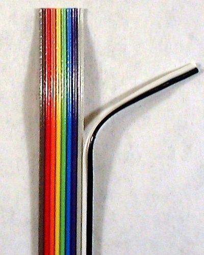

kboring
If you are serious about relocating the face of the CD player it is much easier to wire using some flat ribbon cable like this:

true..where do ug et some shit like that??
