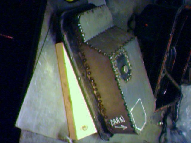

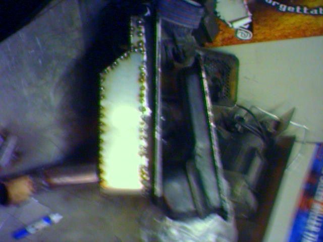

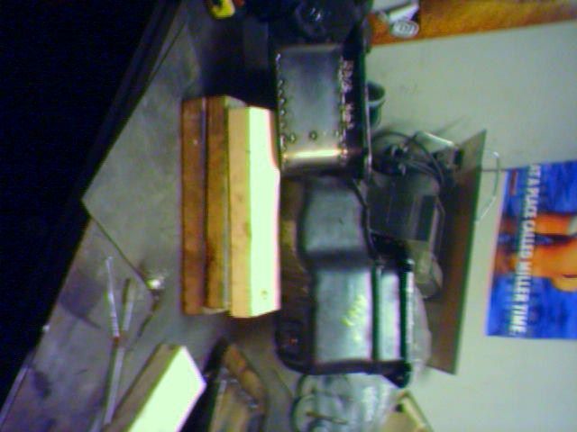

I know Miles (Short Rodeo) took a lot off of his. But, he pretty much built and entire pan off the stock flange. He lowered the frotn of the pan and raised the back to keep the capacity close to stock. I think he lost about .4 capacity or something.
shortrodeo
Edited: 6/23/2006 9:54:50 PM by oOBounce22Oo
Edited: 6/23/2006 9:53:17 PM by oOBounce22Oo
Sorry about the quality but i took them with my camera phone way back when.
I attempted to shorten my origonal pan 1 time.. and it lost close to 1/2 of its capacity, so to take much out of it you need to make it a differnt shape like i did. Like seth said im only shy of capacity by 1/2 a quart and i took like 3" out of the height.
Oh yeah and sorry for the fake out on the Drain location, i wanted it back the in the back of the pan, but thats where the oil pickup ended up so i moved the drain to the front so i wouldnt have any oil flow issues.

And there ya go. The man himself with pics. He already knows how to do it, so if you're going to pay someone to do it, maybe sen it to Miles? If its cool with him.
