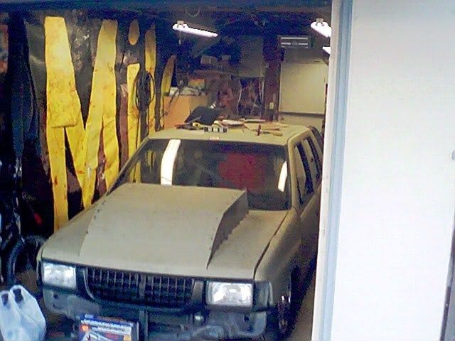

Oh yeah and the oil pan deal might not be an obvious mod when you look at the truck from the outside at a show, but if you dont get the motor down on your doored rodeo this moster 7" cowl hood is what you have to look forward too
