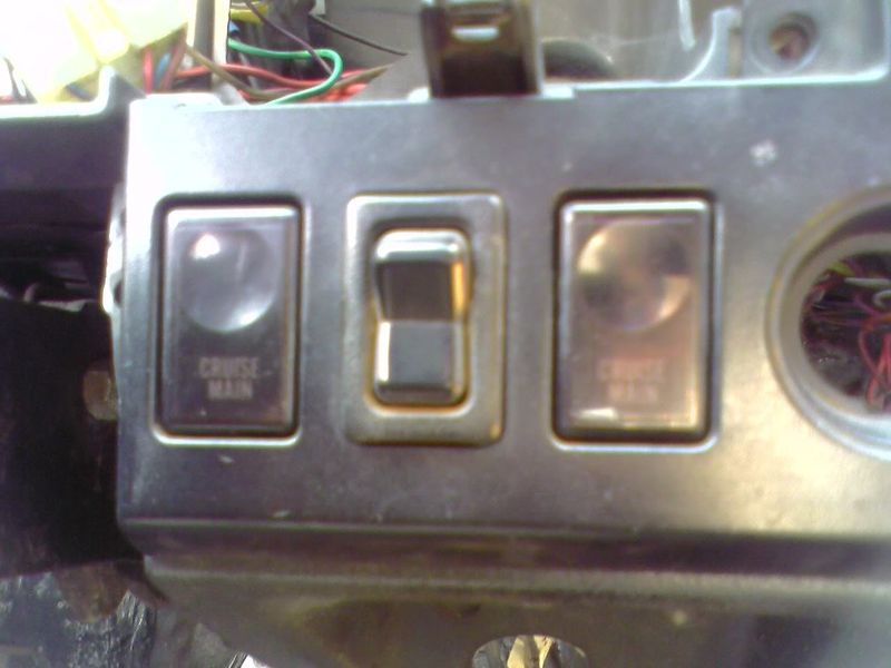

i thought i'd throw my set up on here (since i love it so much)
the switch on the right is ignition/coil, middle is starter and left is compressors (which is also hooked up to a pressure switch).
