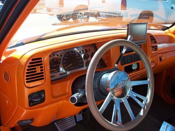

i used 80 grid to take the texture off and then used 180 to get real smooth.
dragginbabyblue's avatar
dragginbabyblue
Thanks guys...and Kyle how much did you get charged for getting the door panels dyed? just tring to get an idea of how much I'm looking at...Thanks man.
tribalade
i used 80 then 180 preped it used bulldog promoter primed it then 240 then primed it then 600 then sealde it then bc/cc
dimebagged's avatar
dimebagged
Edited: 6/21/2006 3:49:46 PM by DimeDown
Originally posted by AiredOut
180 sand, prime, 320 sand, prime, 320 sand, 600 sand, paint.
I did it this way also.
kboring
I dyed them myself. you can buy dye that sprays out of a paint gun. just be careful because it runs pretty easy.
