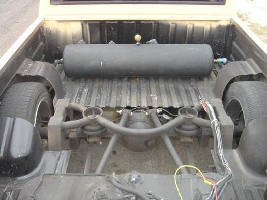

i have a 3 link on my ride with bags on the lower links, without bags on the truck can side to side freely 24", however when i hook up the bags, eight valve system, i cant get it to do a standing three wheel. I've seen lowriders on juice with a chain bridge attached at the pumpkin of the axle and some how this will get my truck to do a standing three wheel better..will it work with the bags? i cant see how it works, they say it makes your front opposong wheel just come right off the ground threefold....wondering if i should do it, looks ghetto but i wanna stand a three foot three wheel

You will also need quite a bit of weight in the rear of the truck. Most hydro setups have a trunk full of batteries behind the rear axle.
JFcustoms
my frame is made out of 3x3 and 3x4 rec. steel 1/4" wall with a lot of x- bracing, it isnt flexing at all. I can three wheel now, just seeing if the chains really do what people say they do instead of running a ballast tank for a high standing three wheel

well chain briges work great if you know where to place the chains and you get the lengths right, but i dunno if a bag has enought lift for it to get the leaver action of the chain bridge to work right, expecialy the hight you want.

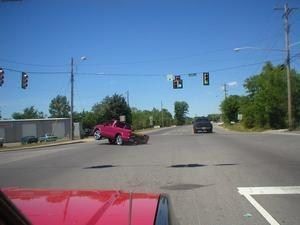

id really like to see picts of a mini doing a three foot STANDING three wheel with bags only anyone can do a three wheel while turnig it takes hydros or air cylinders(cans)

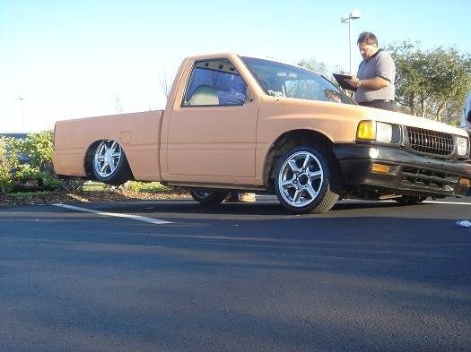

Slammed83Mazda's avatar
Slammed83Mazda
that truck i posted in the pic isnt on cans, No your right it cant do a standing 3 wheel.
But show me another pic of a truck on BAGS, not cans kick a 3 wheel that high
