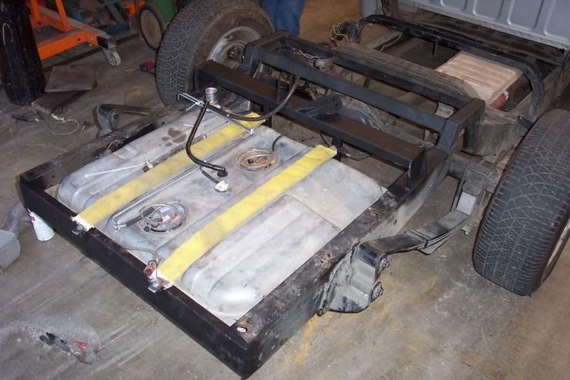

lo tech
you could make use of a different vehicles gas tank, much cheaper than buying a fuel cell..mines outa 87 or so caravan. heres a picture of it, only problem was makin the guage work just right, never messed with it too much, im sure someone knows how to make it work.
