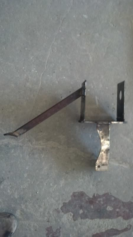

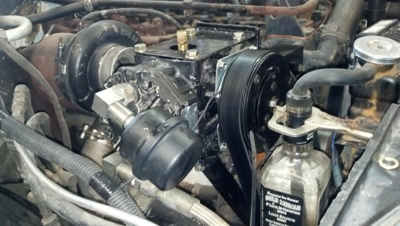

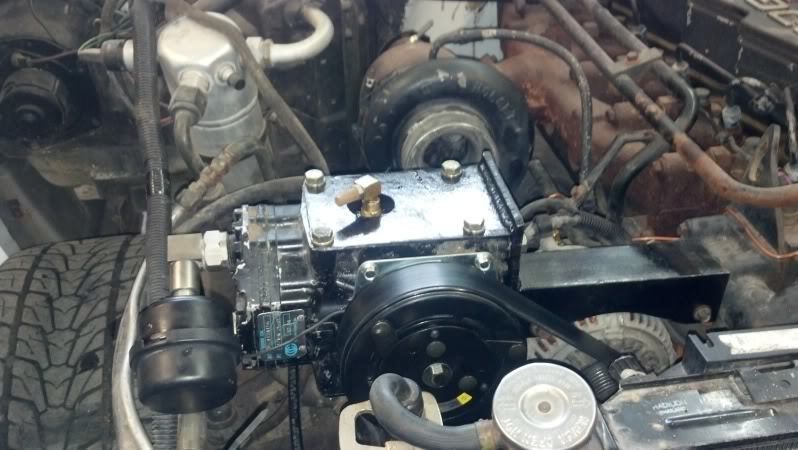

Yea the oasis as mentioned above is a power hog....i have 2 big tractor batteries (1250 CA apiece) and a 250a alternator and my oasis would still make the volt meter move alittle....butif you have a hp1000 oasis it will burn up eventually....i just pulled mine off this past weekend cause motor burnt up after 9 months of service and built an edc
tomnjenn05
Do you have pics of how you converted it to an edc?
comegetsome's avatar
comegetsome
I broke it apart and added an 8 rib clutch to it from parts store....then built a mount off the side of my Cummins
