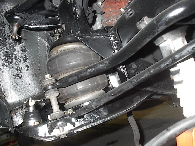

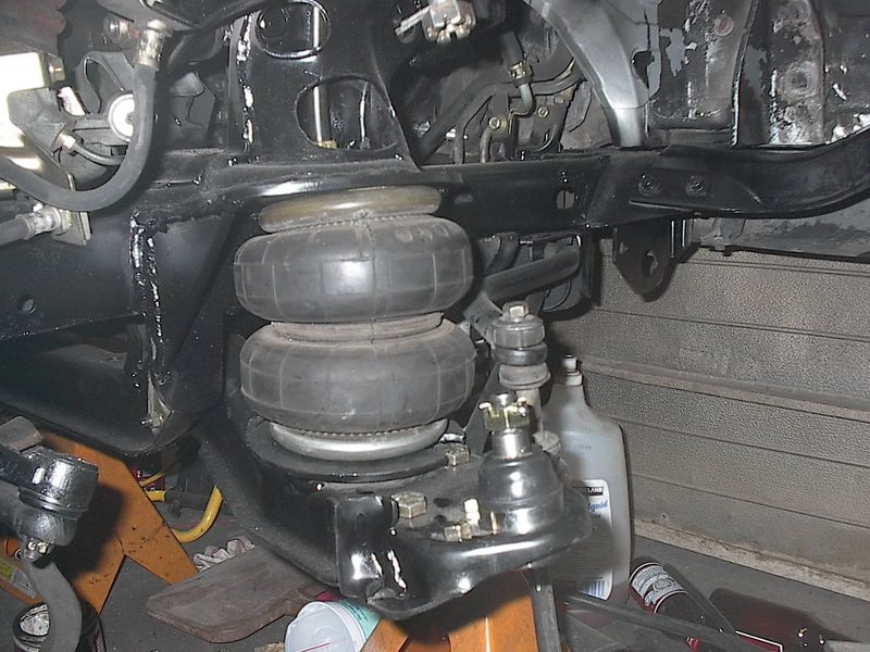

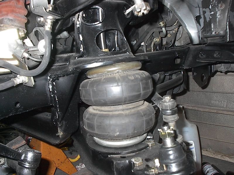

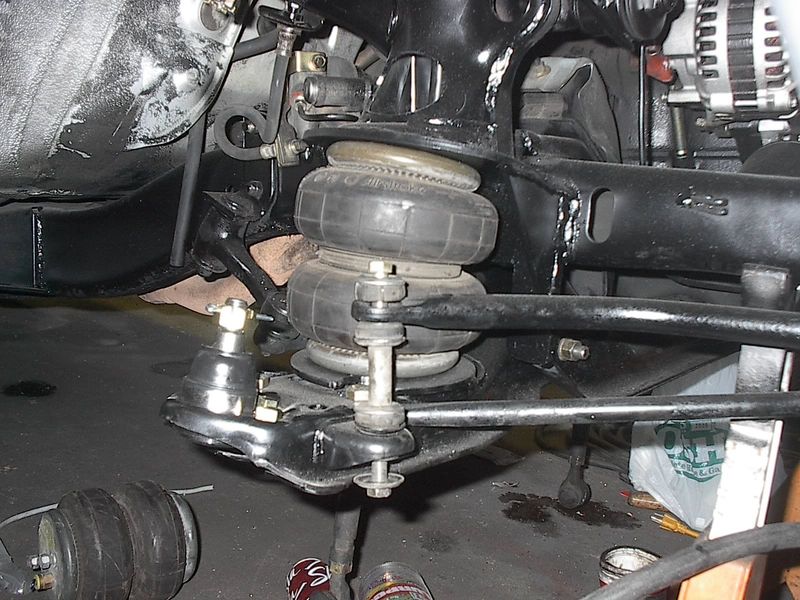

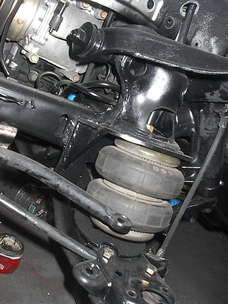

here you go, pics kinda crappy, feel free to ask some ?'s about it.
nvrdoned50's avatar
nvrdoned50
damn that looks pretty good....but does the bag touch that upper gusset when layd out? also got any pics of this truck
onehot69stepside's avatar
onehot69stepside
bag has 1/2 inch of clearance all the way around, If you build the upper plates wider, and set it up just right, you can fit a 7" bag like this. I got this front end setup from krz customs. They used to do all the mitz's this way. Its stronger than just trimming the pockets out... the pockets tend to rip off when just trimmed and using cups. Did you notice how i moved the strut rod/ tensioner rod to the bottom side of the control arm. This is important as to get the lower bag plate lower, and if you leave it on top and move your plate in towards the frame, the bolt heads rub holes in the bag and the bag rubs on the frame when layed out.

those are good pics thanks alot. thast just the way we where going to do it, wiht the gussets and all. also we had the same idea on cutting a hole so we can tighten the bag to the top plate.
thanks alot!!
did u have to fab the upper arms? will your truck lay out fully? the ball joints on ours bind up.
onehot69stepside
this is a customers truck. Its a 94. This is like my 8th front end of a mitz. Every one I have done I have not had to do anything to the upper arms and they have all layed out fully. One even on navigator 18's w/o spindles. Spindles are the best way to go rather than having to cut into ur upper arms.
