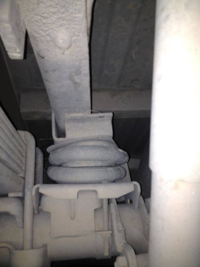

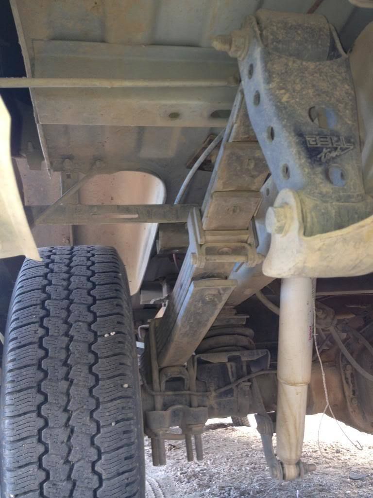

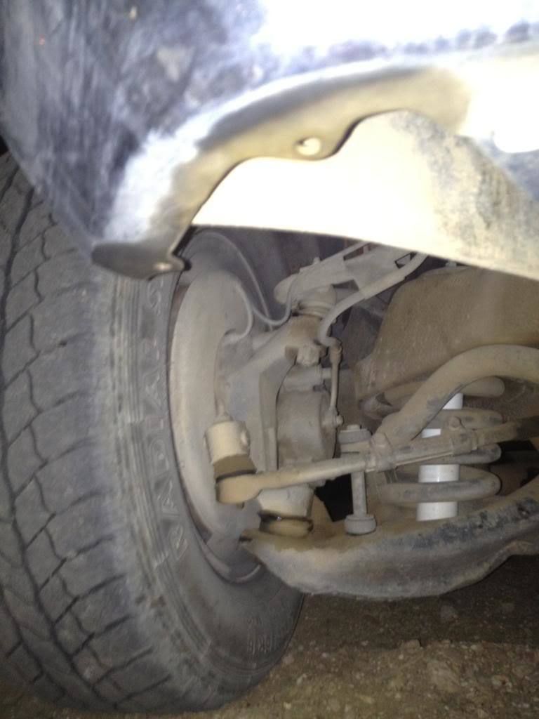

azgunman
Hope these help. Let me know if you need others.
azgunman
calfboy I sent you a PM
azsprsprt
Looks like you just need to get that air bag out of there, the way it was installed will not work with the 4/6 drop, that's what's giving you the harsh ride, im in chandler, if your close I'd be Willi g to give you
A hand
BB
big bear
welcome from northeast ohio. yea that setup is causing you more grief how its sitting.
