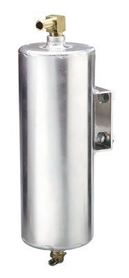

What is the best thing to do with the overflow container? Can you buy a small one that will work at Advance Auto or something? I've got an '01 in my shop right now doing this.

What about this one? The hose is so large at the bottom of the stock bottle, how do you overcome that??

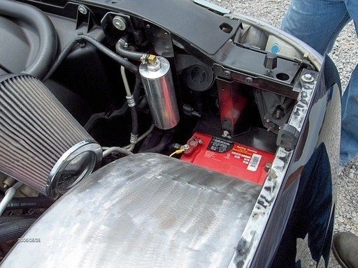

This is what I had in mind-what this guy did, but how does it work with no filler cap plus the huge stock hose is supposed to attach to a 1/4 fitting how?

I think your looking at the upper rad. hose and you just pull off the rad. cap to fill them up they are for over flow.
