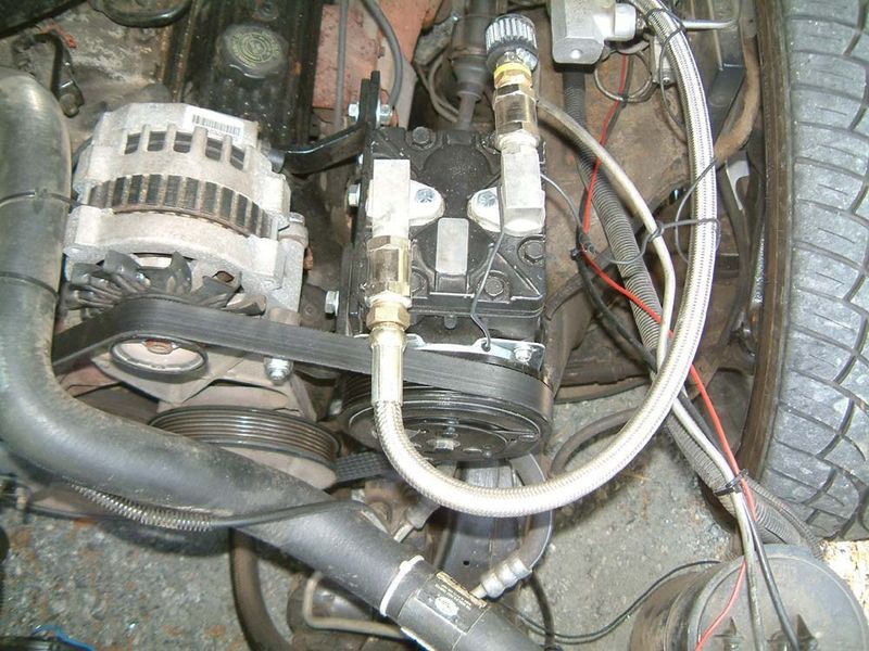

I have a 94 full size with the 4.3 in it and the bracket that I got from Suicide Doors appears to be for a different truck. Anybody have any pics of theirs so I can compare? The pics in the instructions show the alternator on the passinger side, But mine is on the drivers side if that helps.

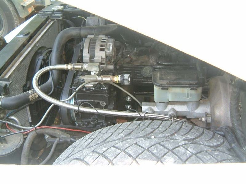

the 4.3 and v8s are the same accessory design, heres a shot from my fullsize, i have the airlift kit, i assume its the same one suicide doors sells.... sorry bout the mess i've had to drive it everyday since the daily broke down, so i havent had time to clean up all my plumbing and wiring....

Thanks for the pics. I'm gonna assume I got the wrong bracket sent to me, cause it looks nothing like the pics.

is it this kit?

It's an Air Lift kit, but they sent me the wrong bracket.

hmmm my 4.3 has a 4 groove serpentine belt setup. I have an 88 fullsize.. i wonder if 88 and 94 had different accessory bracketry.

88 is different.
