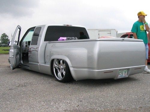

here's proof that it has been done before, this one has a step shaver though

Yea I found that. Kinda worried about being BD with the hang down plate box
Damn that looks hot !!!!

im to the rocker with step shavers and had the gay roll pan that hangs , doesn't even come close to laying so you'll have no problems
