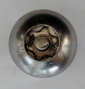

i think hes saying its a torx head
if its like this hit up sears for the bolt

it isn't a torx head
mine stayed still while the impact removed the nut. try using a pair of channel locks to hold the bolt head while you impact off the nut
