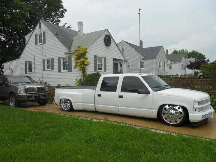

balljoint is not binding. You can see where the frame is laying on the lower control arm bump stops. Took the bump stops out and got another 3/4 to tuck. Have to shave out some of the control arm bracket right under the frame and should be good to go. Here is a pic of what she looks like so far. Oh on a side note. Anyone know where to get a set of clear corner lights for this truck ??? I have ordered 2 sets and both sets did not fit.

Not a clue but thats a sexy truck you got there.

nice man
and maybe it could be because you have a phantom grille there why they dont fit?
Also do you have townasty rears? it doesnt look like the fenders are stretched... just curious

it doesnt need to lay as long as its lookin that sexy
biggi8412
The phantom grill doesnt come over far enough to effect the corner lights. The bottom lens fits good. It is the top reflector lens that doesnt fit. As far as the wheels. Yes i have the town nasty rear wheels. Thanxs for the compliments on the truck. Still have work to do to it, atleast its driveable now.
