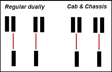

Quoted for truth; here's a little pic I made up to help explain the difference:
Something to watch out for on C&C trucks if you're planning to put a regular bed on it. Not only will the rear end width bone you, the shape of the frame is different too so you'll be making bed mounts and possibly having trouble making the bed sit at the right height, AND...most C&C's are 4" longer in wheelbase than the closest regular truck wheelbase. There are SOME 1 ton C&C's that are the same wheelbase as the comparable 1 ton pickup but most are 4" longer.

After the kick-up behind the cab, a chassis cab frame profile is ladder straight and flat. 34" centers front to rear, which is narrower than a regular pickup frame.
The easiest way is just stand in front of it with the steering aimed straight forward, and look at that pic I just posted and what xtowtruck and I said. A regular dually will have the front tires lining up exactly with the inner duals. A chassis cab will have them lining up dead center between the inner and outer duals, because the rear axle is narrower.
