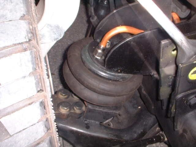

OGDOUGHBOY
we raised mine up 2 inches at first but it wasnt enough so we went with 4 inches so my ride hight when aligned was about 2 inches off the ground lol
not the best pic i know but this is how it was with the 2 inch lift brackets
some pics layd out after we riased them another 2 inches so 4 total
i have video of it rolling at ride hieght but ill have to find them if you want i can dig them up

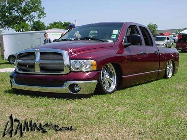

Here is mine raised 3 inches.
I have it set so i can get good ride hiedth.. it is almost stock .. But i can set it up so i can roll with no camber at 2 inches if i wanted (but then again i also have shortened lower control arms) .. But then it gives to much positive camber to turn .. Anywhere is a few pics..

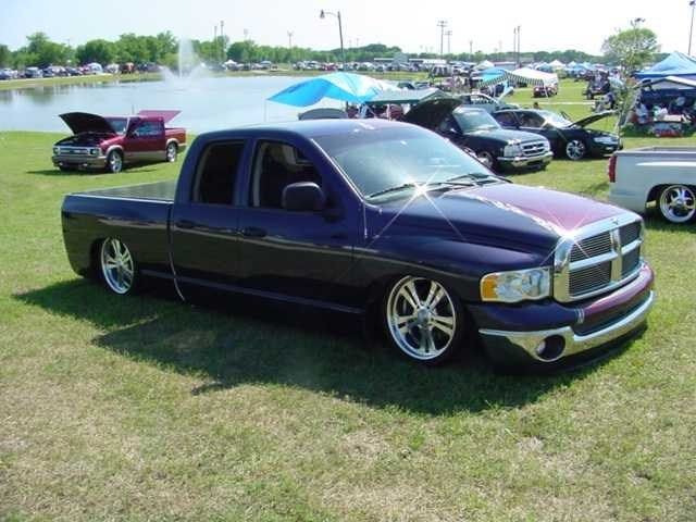

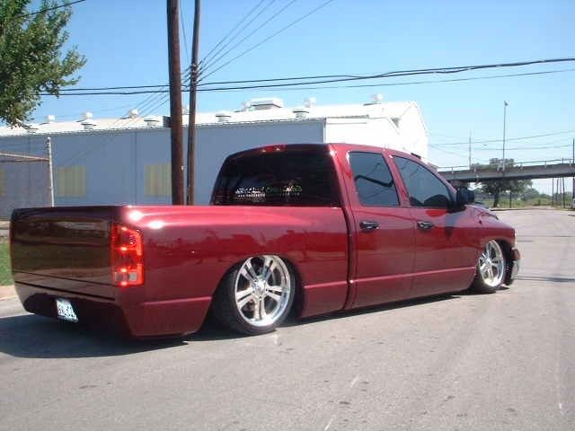

Ben Laynbody on here has some pics of a truck he did for a customer.. I like the looks of his the best yet..
Before
After
