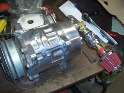

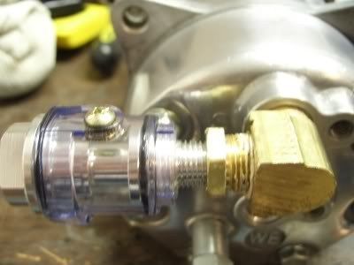

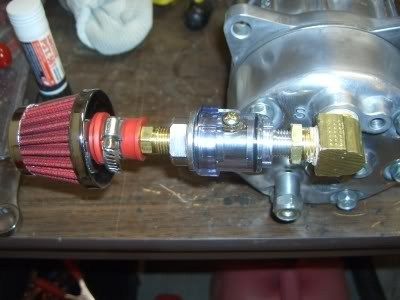

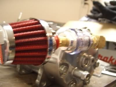

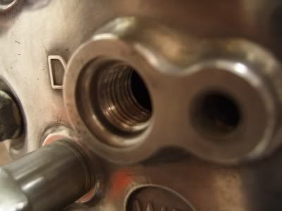

I took the rear cap of the compressor and had it tapped at the machine shop.1/4" pipe thread on the discharge, 3/8" pipe thread on the suck side.I ordered an Viair leader hose and an ASCO water seperator from Ricky at whynotfab.com and hooked them up to the discharge side.The fittings I got from the local Parker store and used it to hook the in-line oiler i got from sears and the filter from autozone.I also ordered an ASCO pressure switch from Ricky. You hook it up like any othe 12v compressor.I'm going to have to get a 90 degree fitting for the leader hose, there's not enough room for it straight outhope this helps, I don't have it in the truck yet, but i hope I should this week.Email me with any questons you might have.oh yeah it's a sanden 708

All I did on mine was get fittings pressed on. I dont run an inline oiler, I just spray some oil in there everyonce and a while. 200+ psi daily on 14 gallons. Works great.

why not run an inline oiler? it's $10 from sears. The filter was $10 and the fittings were $5. The reason i didn't get my fittings pressed on was i didn't want to hack up any of my stock A/C parts. It would take me around 30 minutes to go back to having A/C. Here is another forum on it.

roknmotor
does the oiler (suction side) have to have any certain size ports????
kaoss's avatar
kaoss
i don't see why it would. the one i have is 1/4"
