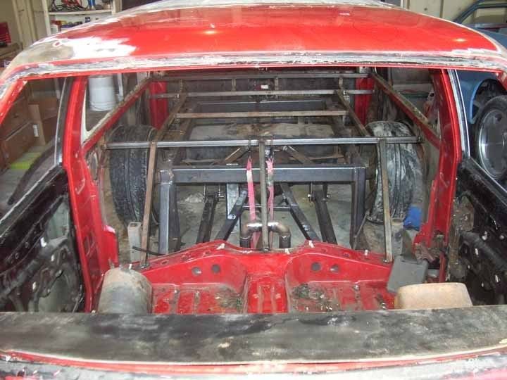

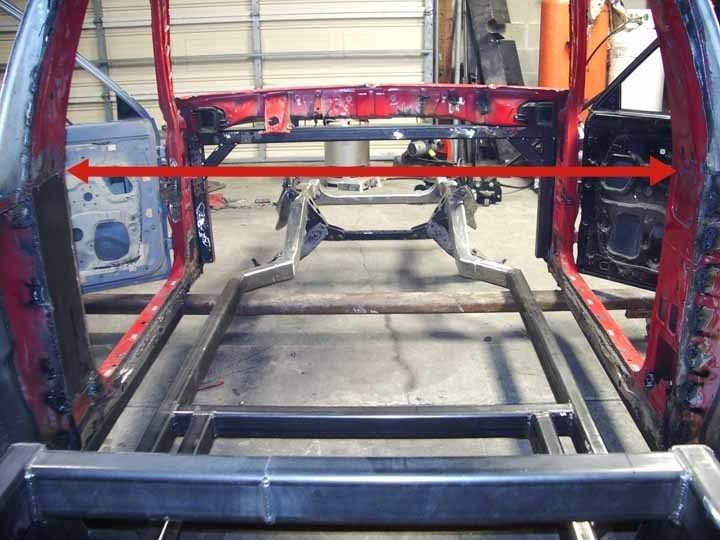

Can somebody get some measurments for me? I need the two below.
BTW, the reason I didn't brace it in it's stock location before I cut it out is because it wasn't in its stock location, the body was messed up before I cut it out, hell that's mostly why I cut it out.

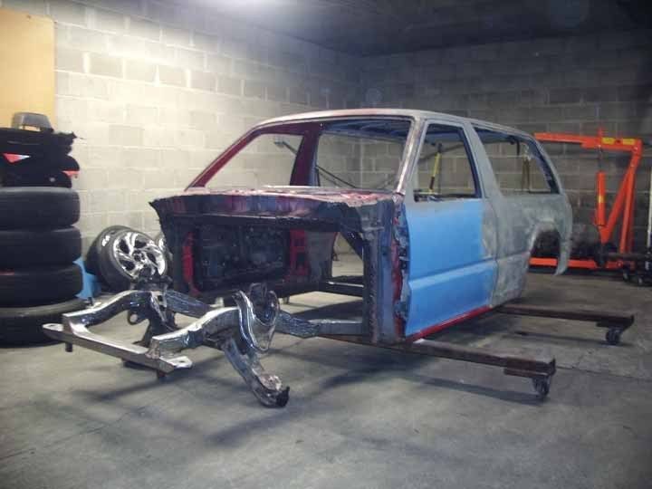

i'd love to help out, but my cab is full of stuff right now! haha
a sneak peek pic eh.

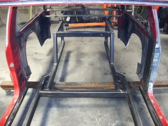

I have been trying to get the body straight and thought that maybe I should see what a stock cab's measurments were.

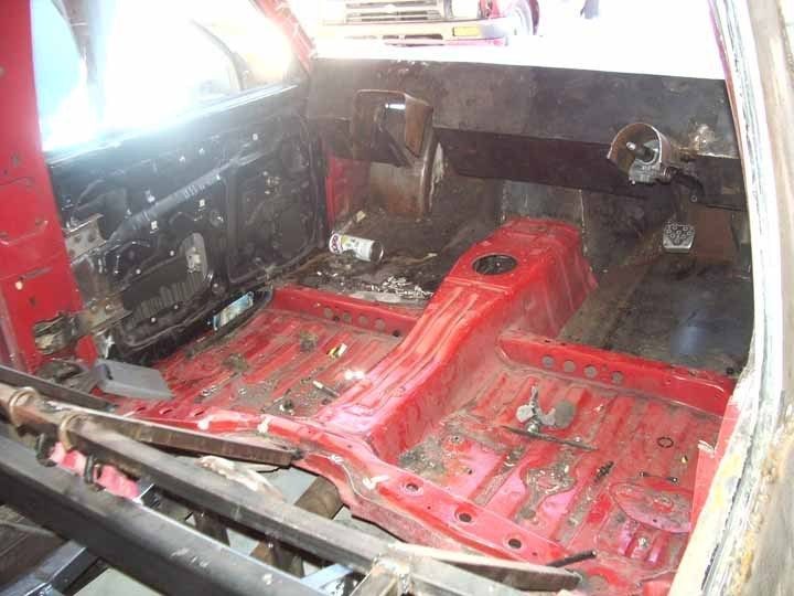

most guys can get you the back measurement but I dont knnow how anyone would be able to measure the front one unless their tranny tunnel was cut out like yours...
cookiemonster13's avatar
cookiemonster13
well russ d they may be able to use a framing square on each side to get a straight line above the tranny tunnel. also some could lift there truck up measure rocker inside edge to rocker inside edge. just a thought

Oh, yeah. That is a good point. Well the back is the most important anyway.
I already braced the front and got it all squared up, I was just wondering if I was close. All the fenders and radiator clip bolt up so I think I am fine. BUT I guess if the back is off and I correct it it might throw the front off. It was just so hacked when I got it I had to start over, I will see if I can find a before pick.
I am having a problem with the back, it's just a little tweaked.

I have a 89 Ext Cab. When I measure from the back of the doors (pinch molding) I come up with 55 1/2 inches. Hard to measure the structure as I still have interior. Hope this helps.

55.25inches...from the interior.87 single cab mazda.anytime man...anytime.

Holly Shit! Mine measures 55.5, so I am close. Did you measured with the plastic interior on?
