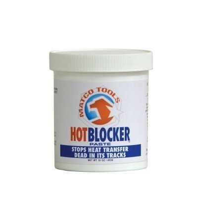

ive got some heat block stuff from matco. it works gooooood

home depot sells some spray on heat blocker in their welder section for under $10

Im starting my sheetmetal work this week gonna get the bedwalls and tubs done up for lay'd out...When i put the new sheetmetal in how can I protect the back from rusting seeing as how i cant really get behind there once its welded up?? and what is the heat blocker stuff.?

or flip the bed over and por 15 that bitch u can spray it right out of the can. heat blocker is a substnace that absorbs the heat from welding to keep from warping metal. thats the stuff i got, once it dries after u weld tho its no good,so u just reaply it and water and a rag washes it off
here are the specsHot Blocker Paste is designed to provide a protective heat barrier and to retard the transfer of heat through metal during welding and soldering applications.
