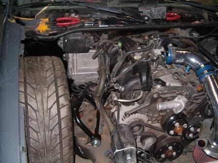

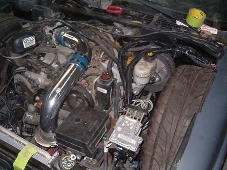

Im in the middle of body dropin mine now and i was gonna try and keep my heat and fit 20's. but there is A LOT of reconstruction your gonna have to do. i had to cut about half of where my blower box used to be out for the wheel tubs. and its gonna be a tight fit already with the 20,s
heres a pic...
i have a similar question. will i have to remove my ac to body drop and have 20s? i really wanna keep the heat and air . it is driven alot
I may be wrong, but i see VERY little room to fit a blower box and blower motor. I feel I could be wrong tho...

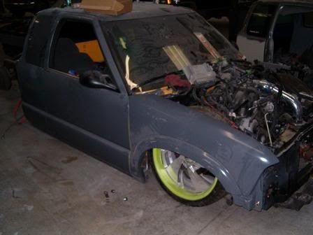

Lowpuppy
when ur BD on 20s everything is close on clearence issues, you would have to go with a vintage air unit. theres no problem keeping AC if ur bagd on 20s, i usually build a new one out of sheetmetal thats smaller and angles up to clear the wheel but when u BD it on 20s there is not alot of room to work with. heres a few pics of the one i'm building now thats BD on 20s
