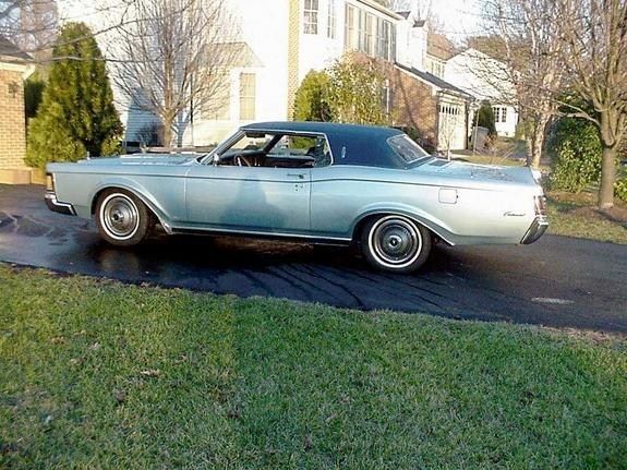

thad be pimp, do it for sure

mine looks identical just red with black top im looking for rims for it what is the lug pattern anyone know?

lug pattern is 5x 5-1/2, same as fullsize ford trucks.

IM THINKING ABOUT 20X8.5 ON FRONT AND 20X10 ON THE REAR WILL IT WORK

i know the 8.5 will work just fine up front, but the 10's might be a little tight in the rear. We just finished a 65 lincoln here in wichita, and it had 17x 8's all the way around, the front had a smaller tire, like 25 or 26 inches tall, but he back had like a 30 inch tall tire, im thinkn it was something lt was something like a 255/70 or something, it was huge for a 17 inch wheel, but it was quite a bit wider than the wheel and it fit fine, and just barely rubbed the wheel lip around tight turns

yeah i want a little wider look in the rear of the car. i think maybe ill just have to stick with 20x8s all around

u be totally safe with 20x8's. u could just get a little taller and wider tire to compensate for the look ur wantin!!
