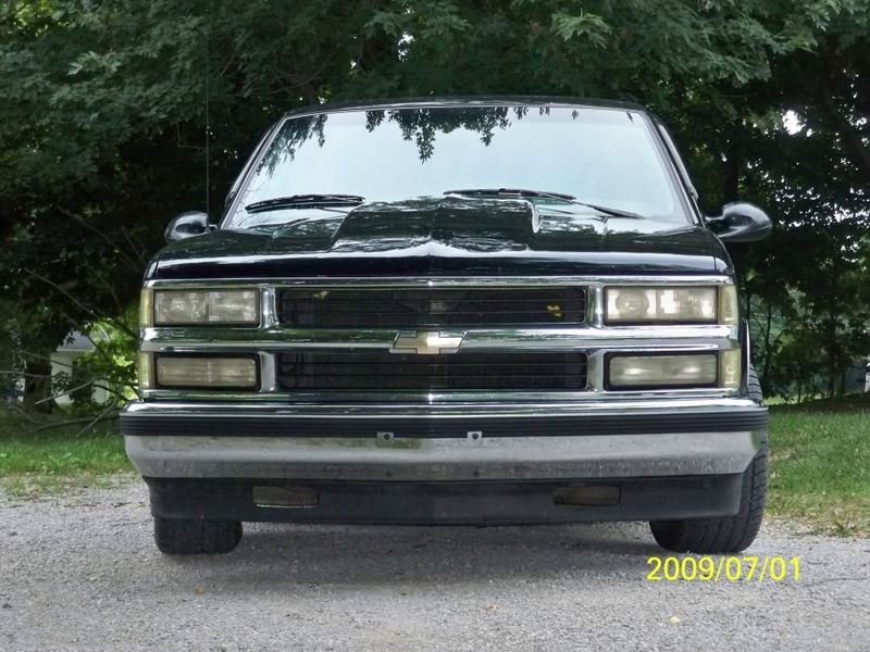

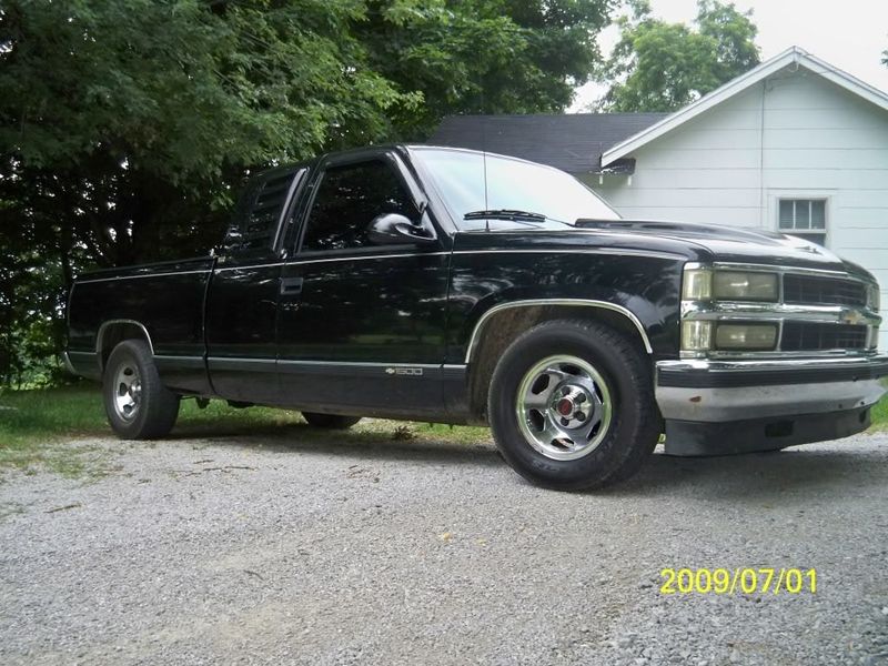

Just joined site today, a matter of fact I just found this site today! I've been lookin it over for a few hours and I had to get in on this, great site guys!!! My name is Brent and currently reside in Glasgow, Ky. Not currently a dually owner but have a conversion I'm gettin ready to start (with the help of this site!!) Ok heres what i've got in the works- 95 Silverado ext. cab short bed, 240,000 miles still runnin the ol' 350, 5 speed swap(due to another 4l60e biting the dust), steel cowl hood, already has a slight drop, & ridin on some sport wheels. Don't get me wrong, I love my truck the way it is but I've always been partial to the idea of a slammed ext. cab 2wd dually... So I'm kinda new to trucks as far as suspension, I've had numerous mustangs, camaros, T/A's and a ton of bikes from Harleys' to Hayabusas' but never done any modifying on trucks. I know theres more than enough people on here with the knowledge to get me in the right direction on this. Heres a few pics of the truck as it sits now to give an idea what I'm working with
