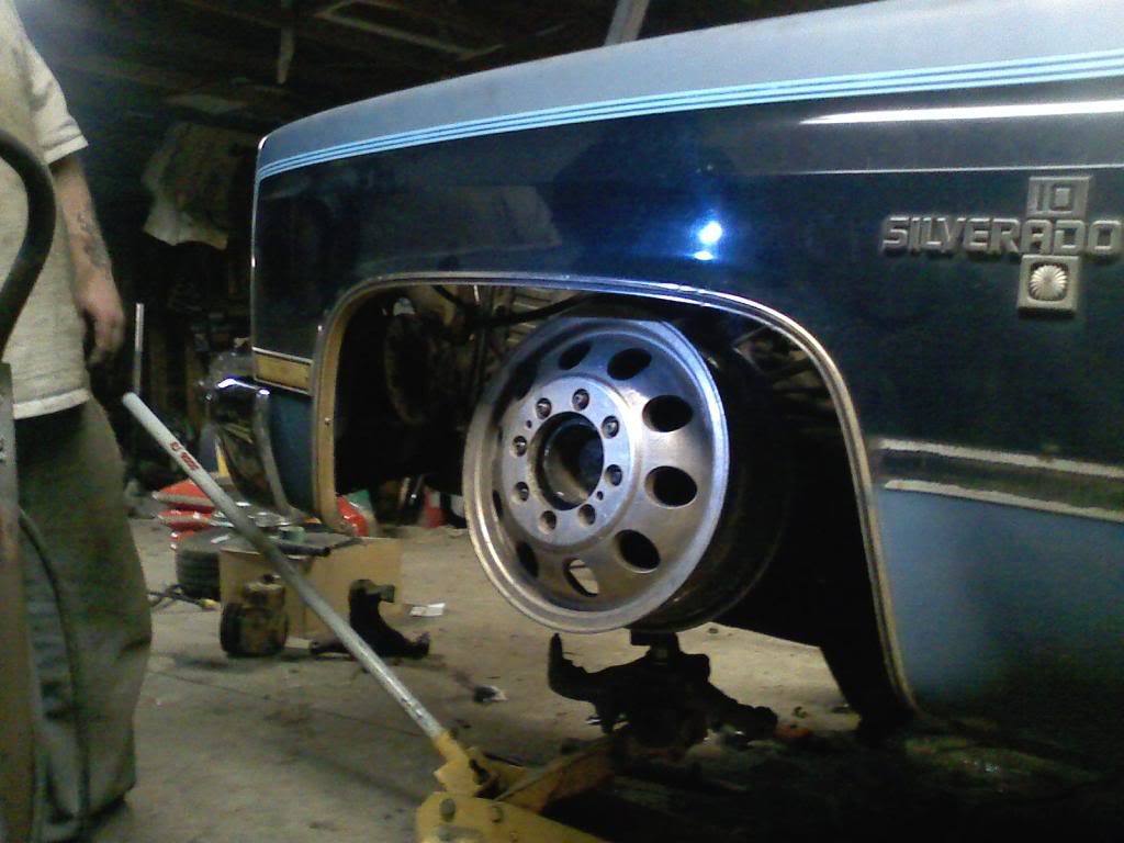

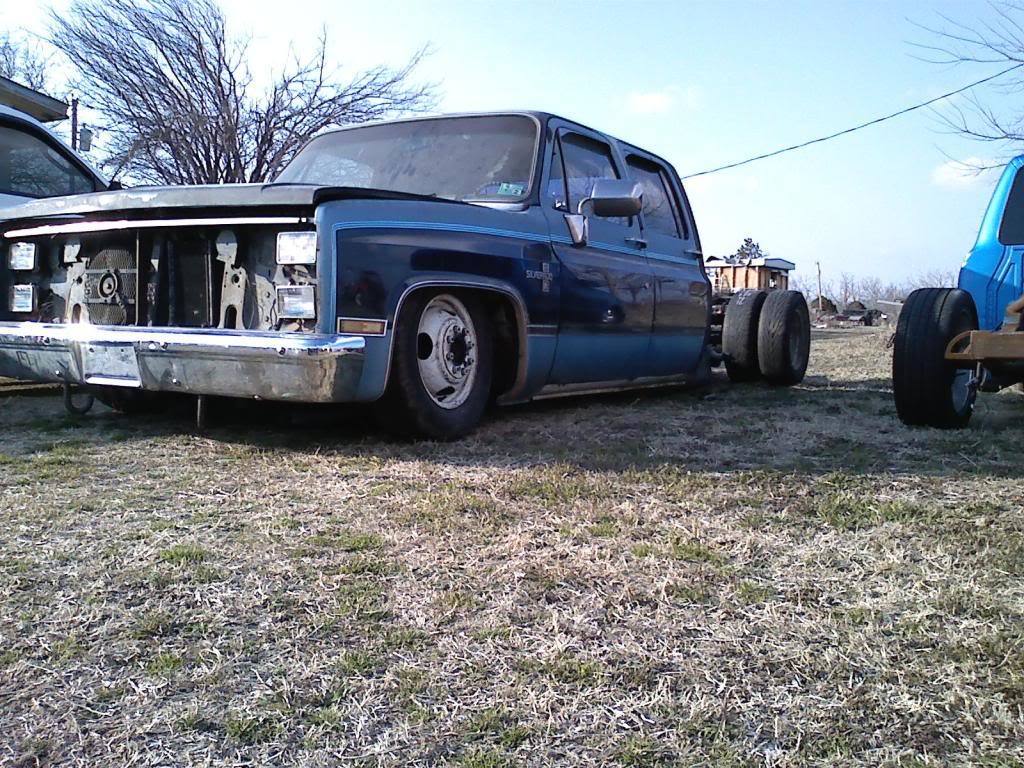

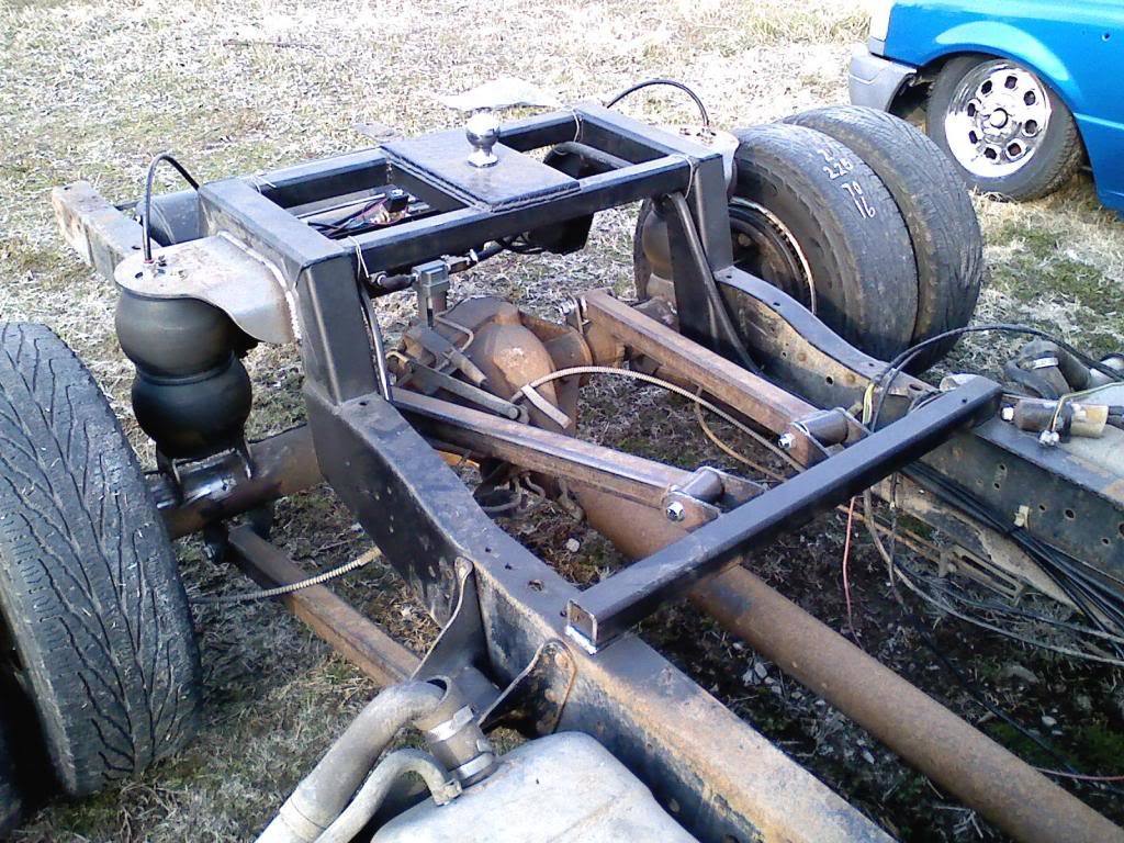

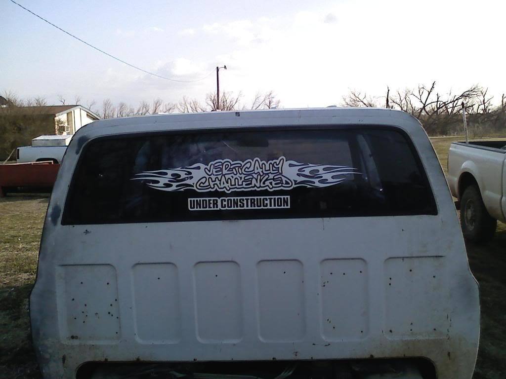

I have an 86 crew cab C30. Its got the 454 with the 4 speed manual trans. Right now it sits on the stock steel wheels but I have a set of 16 inch ultra aluminum wheels for it. The truck looks really rough right now but it is still a work in progress.

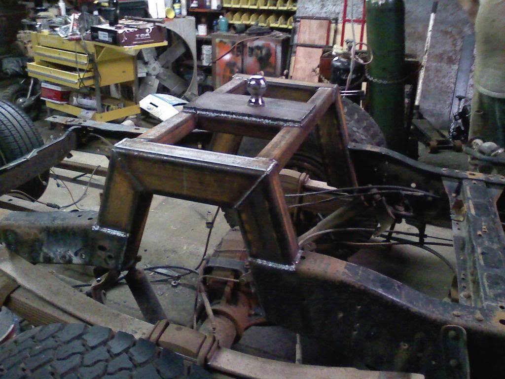

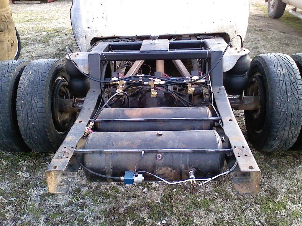

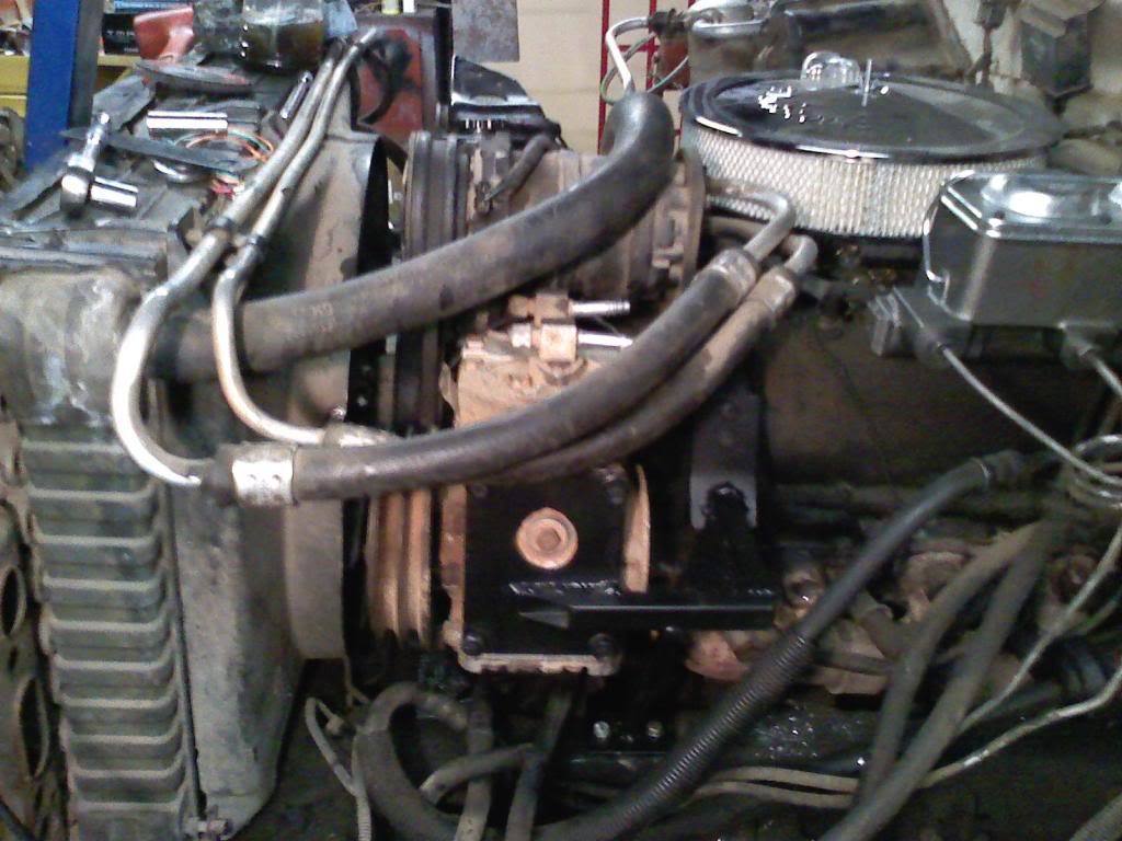

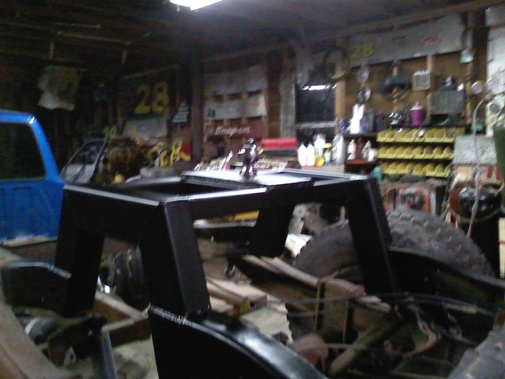

The truck is bagged front and back. The front it the suicide doors upper plates and plated LCA's to get it to lay out. The Rear is a custom built Trialgulated 4 link(2x2x1/4 bars) BOA setup. The truck is running Slam RE7's up front and Slam RE8's out back. The notch is 3x4x1/4 with a 2x2x1/4 bridged. The gooseneck mount is a piece of 1/2in plate with 2x2x1/4 bars that it is welded too. I'm running a 6 valve setup. 4 in the front and 2 in the rear. The valves are 3/8 SMC's. I am running a York EDC on a custom built bracket.
Now the most important part. THE PICS!!!!!!!!!

welcome bud.. looks like a helluva start!

Lookin good!
