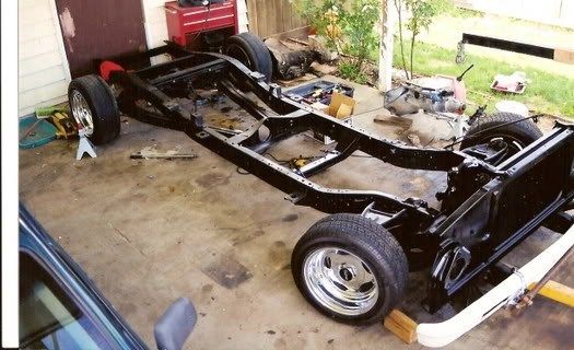

I did this one about 5 years ago I wish I had more pics its pretty easy you take exactly 12 inches out of the flat part under the cab and take 8 inches off the back you do have to move the rear cab mounts.

looks great! Thats exactly what I was talking about too.

Thanks Russ when the frame was done it was on 20's and it drove straight down the road I took it to a frame alignment shop just to double check and they couldn't tell it had been shortend. I miss it so i'm starting on an other one.
