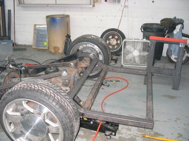

Here is mine.. plain and simple but very effective
damn it I can never get my pics to work here

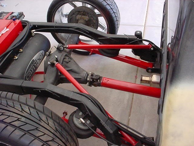

I did the a triangulated 4 link with the a backs on lower bars, haven't driven it yet but i hope it rides really nice, those are 2600# bags, upper are 38" lowers are 36". I tried to put the bags as far forward as i could, as u can see its pretty tight clearance, bags are almost halfway on the bars.
