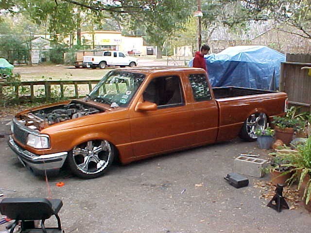

I have a 97 ranger bagged and layin frame. I want to body drop it now. Anybody have any suggestions. Whos ever body dropped a ranger? Feedback would be nice. Later

std or ext cab? stock floor or reg floor? wht size wheels?

It looks like a ext. cab w/ 20in.

if i body drop it, im putting stock wheels back on. and were gonna traditional body drop it. no stock floor.

trad. floor 3.5 inches. dont stock floor it tehre bitch cuz the frames are crooked.u will need a fuel cell.

trad. floor 3.5 inches. dont stock floor it tehre bitch cuz the frames are crooked.u will need a fuel cell.You dont need a fuel cell for a trad. BD, mines still in the fac. spot just raised up and its a very clean look and easy to do!

we already got a fuel cell in it. I just want to kno wif Im goign to have to pull the dash and engine and stuff like that. What little things are going to be hard. This will be our first body drop so Im looking into it a whole whole lot before we start. Later

It will be easier if you pull the dash. You won't have to pull the engine but you may want to pull the radiator and stuff. Don't have to just makes it easier. There are pic on my cardomain site. I won't post them all here and use up their server space. I just did mine through the summer so if you have any questions just hit me up here or on aim under ngacleetus
