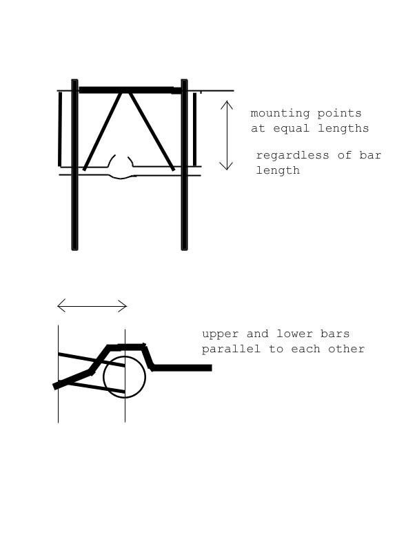

is this something like how your making your 4 link?

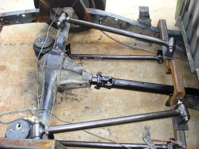

no i dont, pretty much i have a 54" arm in length, on the axle they 26" apart center to center and all the way at the tranny they are a foot apart, they look almost straight, will it keep my axle centered..i know their should be a certain angle to the bar and i wanna know what it should be....the bar at the front is 6" from center of frame and the rear bar is 13" from center and the bar i 54" long
JFcustoms
yeah that style
