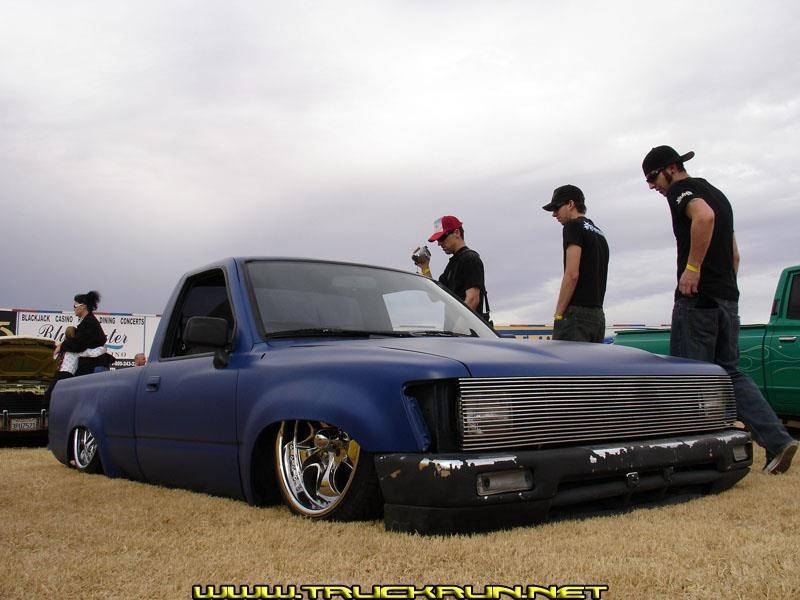

DOORED YOTA WITH A STOCK HOOD WITH FUEL INJECTION. HE LOWERED THE MOTOR MOUNTS ALOT FOR THIS ONE AND HAD TO SECTION THE OIL PAN.

DOORED YOTA WITH A STOCK HOOD WITH FUEL INJECTION. HE LOWERED THE MOTOR MOUNTS ALOT FOR THIS ONE AND HAD TO SECTION THE OIL PAN.and its comfy to ride in and drags on 18s
